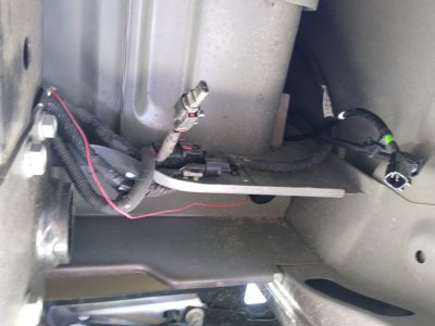

I used waterproof LED strip lights on my buddies 2500 w/8' bed. Added a fuse and safety shut-off switch also.IMG_20161016_154801759.jpg2016101695194123.jpg

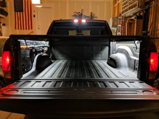

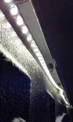

I just put them under the rails like others here posted. I wired mine directly to the existing lights, the length was perfect on each side and theres an existing hole to route the wires towards the top. I saw no need to wire in a switch since I dont mind using the dash switch when needed. I've had these installed for little over a year now.
https://www.amazon.com/gp/product/B0792RT7ML/ref=ppx_yo_dt_b_asin_title_o08_s00?ie=UTF8&psc=1
They sell many different types of these strip lights, some are even RGB

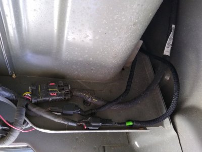

I bought the bed light kit at the dealer and it was delivered the following day. My project for today was plugging the light cables and switch in. It was plug'n'play as far as hooking up the cable terminals; the plugs were taped back and had plugs to protect the terminals. The kit included the cable to go into the engine compartment but it wasn't needed. I don't think there are any terminals taped back in the engine compartment but I'm not totally sure. Could it be that all I need is to do is add a fuse in the fuse box? No lights yet right now.
