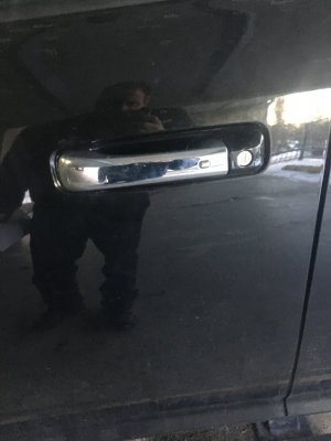

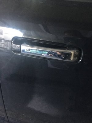

So today I tried replacing my hub with alpha and kept giving error about secret key method or something like that.
Put old hub in and ignition switch and drove to my local dealer .
The service manager there is really good .He has bailed me out a few times when i corrupted my truck with AE a few times
Not sure what most dealers would charge but the service manager did it for free for me .
I will be bringing them some coffee and donuts this week to say thanks
So the new hub is suppose to get the code from the pcm automatically he said .
With alpha you can’t replace hub unless there are keys programmed to it .
So there is something in alpha that needs to be fixed or explained as too get the procedure done .
So we continued on with his mopar service tool and got the hub and keys programmed in 10 mins .
Cleared all dts as the abs thru some codes etc
Spoke with jimmy 07 ahead of time and he had suggested these points be turned on .
I added the passive entry to set
Fobik Safe enable and passive entry
Csm .Thanks jimmy for the info !
The system is working now .
Will buy door handles next month .
Hopefully the alpha developer can get this figured etc .
Then no dealer intervention is needed .
Here is some pics
