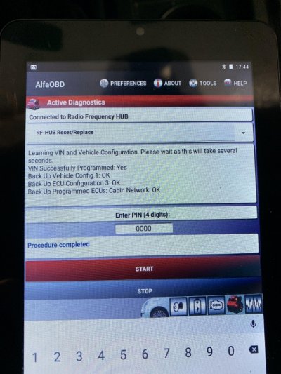

Ok, I got it working. After the hub replace, I lost the TPMS sensors, and the truck would die after a couple seconds. Cleared all faults, performed hub replace again, and truck ran fine. Still no TPMS. Had to perform the sensor rolls test in the RF Hub menu while driving, and now all is good. A few things, though: to program the fob, I had to use my original truck PIN, but to reset the new hub, I had to use 0000. This remains the same now that everything is working, too. To program a fob, I’ve got to use the truck’s PIN, and to update the hub (after a TPMS threshold change) I’ve got to use 0000. One other thing, fobik safe isn’t working for me right now, so I CAN lock the fob in the truck. I don’t have the door handles installed yet, and I’m not sure if that has anything to do with it. @skuppy069, did is fobik safe enable working for you now, and did you notice if it did before you installed your handles? @mjf6175, I remember you went through this also, any thoughts?
All push button start prompts and proximity prompts are displaying on the EVIC as they should.

So the summary of steps for you was hub replace twice using 0000 pin, program fobik using truck's pin, and then sensor roll test in hub while driving? As well as the other settings for fobik safe which you enabled previously.
Jimmy07
Feb 23, 2017
3,512
3,565
1)Enable keyless go, passive entry, fobik safe, and passive entry CSM first in the BCM. Program fobik highline with your truck’s PIN. 2)Reset RF Hub with 0000 3)Clear all faults in RF Hub (and reset hub again if truck won’t stay running). 4)Perform sensor rolls test while driving if you lose your TPMS sensors.

Ok, I’ll keep fiddling with the fobik safe feature, otherwise I’ll see what happens when I get the handles in.
I did drive around for quite a while to see if the sensors would get picked up, then as soon as I did the rolls test, they immediately popped up.

Ok that’s interesting that the sensors didn’t automatically get picked up after 5 mins or so .
It is interesting that the pin is 0000 to access saves changes in the hub .I might try and check mine with alpha this weekend and see if the pin is 0000 or if my pin is the same as before
