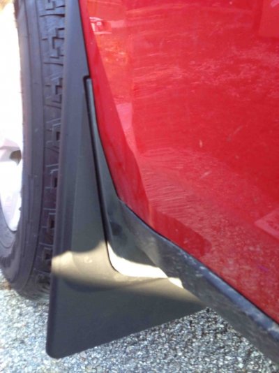

Have any of you guys had issues with the OEM Ram Mud flaps collecting Debris and rubbing the paint?

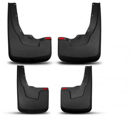

PIC of OEM mud flaps:

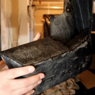

Here is a Pic of the OEM mud flaps after they were removed:
There is a big void the ram chose to fill with foam. Unfortunately, there is just enough space for Debis to collect between your paint and the foam.
Anything abrasive in this space will remove paint over time.

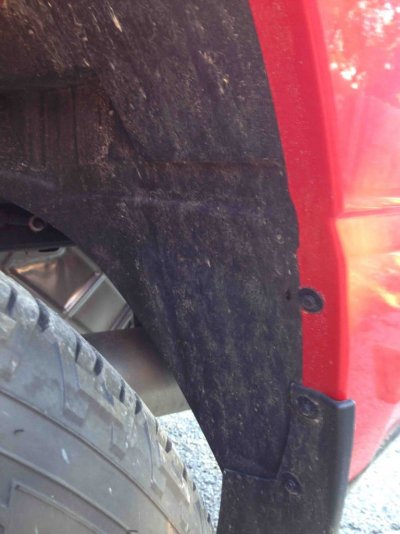

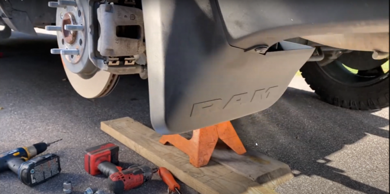

I chose to go with a flat mud flap that doesn't ruin my paint:
These are a no drill design and have held up well.
