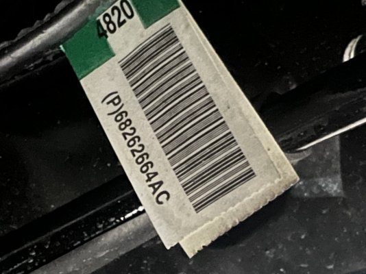

Old thread I know but my 2019 Laramie quad cab 6-4 box with ORP has springs PN 68262686AB.
Any one know what the PN is for the same truck without ORP?

Non ORP Crew Cab with 6.4 bed
Below is ORP or Rebel
