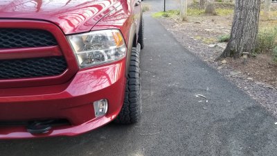

check out my recent thread. I just tossed a +1 offset wheel on mine and it's damn close to sticking out too much.
Naw man, I looked at your pics and that looks perfect.

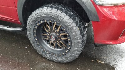

I stuck with 18X9 with a +18 offset. They are perfect pushed out to be just barely in the flares. They are right on the edge and keep most mud in the fender and not all over the truck. Plus it does not look like a Go Cart.
