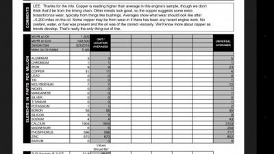

Today I got my oil analysis back looks good minus the copper being high not to worried just need to research it.

what oil brand and weight?

That is one of the better UOA's I have even seen on a Hemi, with that calcium it doesn't appear to be an oil you want to leave in for a long interval, but there is zero problem with that copper wear in a Hemi. Most seam to be 40-70ppm copper wear in Hemi's.

Good to hear I only had 1500 on this oil change I may just switch to a dino and Do it every 3-5k and be done with it. I did the analysis because I have a weird sound in mds when coasting. I was worried about the lifters and or valve train. The sound I whole heartedly beilve is the timing chain guides are wore out not very common but have found a few with same problem and i feel I can rule out major valve train issues.

That is why it is so good, lol. Only 1500 miles, this I did not know. But, there is nothing out of the norm for sure. I drive in tow haul 24/7, I don't like the bogging sounds as well in my 2010 6 speed. Sounds like a plan, I really like pyb for a dino oil, crazy good for 15 bucks 5 qrts at walmart.

I run in manual select 5 all the time. If I'm coasting in mds it sounds like a locus It's awful but If I keep mds off no noises.
