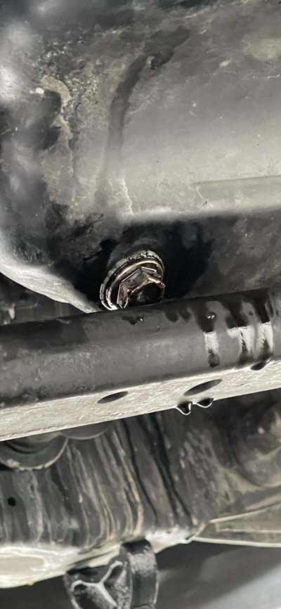

So, I have a 2011 ram with the 4.7 engine. I had the engine swapped out a couple months ago with what I was told was from another ram truck.
So now today I go to change the oil, only to see that the frame is right below the drain plug. So I wasn’t able to use a socket and used a wrench to loosen it up. HOWEVER, it only gets loose to a certain point until it hits the frame and can’t come off completely. Oil barely drips out.
My question is, is there a solution to this or am I just SOL?

Just throwing ideas here:
Is that frame piece joined, or say go to each side and attached by bolts, or is it a solid welded piece? Pics not show. Was the same size engine put in, or is it a different size? Did U have any issues on engine that was there ref draining oil?
Other option get another drain pan with different location or you can get a dorman part (another drain), drop the existing pan and put a drain at another location.

The frame piece is welded on each side. The engine is the same size engine, the 4.7 magnum, I had it swapped because original had bad bearings. I’m thinking getting another drain pan may be the best option.

The engine was purchased from LKQ and a local shop did the swap
I would take it back to that shop. I feel that should have been something they would notice and bring it rlto your attention. I would see what they can do about swapping the pan or installing a drain if it would clear the crossmember.

But, if youre in a pinch, see if you can loosen one of the motor mounts and jack the engine up a bit from underneath with a hydraulic jack and some wood blocks, or on top with an engine hoist. See if you can find some spots to support it with a jackstand after you lift the engine as well since you cant fully trust hydraulic jacks. If i still had my truck, i'd be able to provide more detail, but i think you understand the concept
This sounds sketchy, but you did ask for possible solutions. Proceed at your own risk, and good luck.

I bought the engine. They said it was from a 2010 ram when I purchased it.
If the engine is from another Ram,that makes me wonder if there might be a differance in the 4.7's oilpans between a 4X4 truck and a 2 wheel drive truck.I've never looked into the 4.7's oilpans,but it might be worth researching them to see if there is a differance

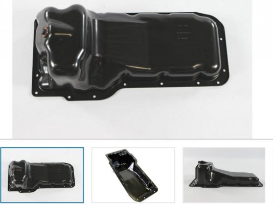

I'm trying to figure out what that pan is out of. Can you post another pic maybe zoomed out a bit.
This is the pan that's supposed to be on it according to Mopar parts site. Maybe they got the engine out of a Dakota.

I am not clear either is that a frame part?
Or what?
If it is a what, I will assume you can cut and or grind a 1/2 moon in it.
Or change out the pan.
personally I am pretty sure I would have moon it and make the edges all really smooooth
