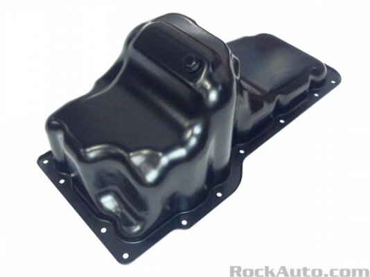

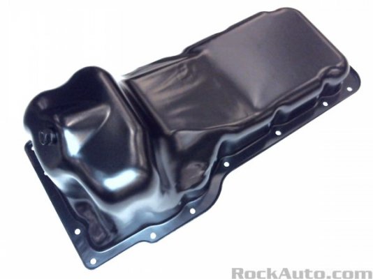

You "could" hack it, but how long would you want to put up with the mess every oil change. Oil hitting the member is going to go everywhere, esp. if hot.
OP is the drain plug in the center of that flat area on the pan or off to one side?
If off to one side, it is of a much older vintage engine than what you were told.2006 4.7 oil pan.jpg2011 oil pan.jpg
