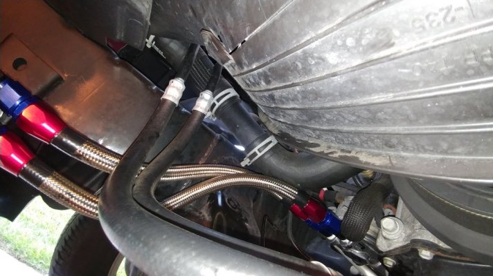

AN fittings and AN braided hose, all fittings and hose I used was Vibrant Performance from Summit. I ordered a 10ft piece and trimmed it to length with an angle grinder with a cutoff wheel.

The Derale oil filter adapter comes straight down out of the block, so you might need two 90° fittings? I used two 45° fittings but my adapter had the output pointed towards the front of the truck.
