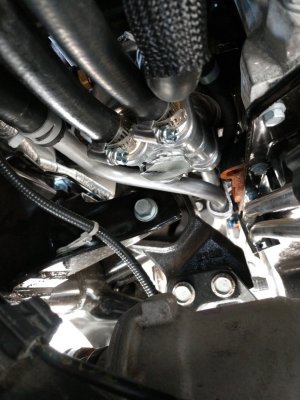

2017 Ram Rebel 5.7L 4x4. Lets do an oil change at 2000 miles to get factory oil out and good oil in. Easy right? I thought so since I have done hundreds of oil changes in my 50 years.
I crawl under and search for oil filter. WTF? Who stuck it THERE?!!! This is going to be fun ONLY ONCE, because I am doing a remote oil filter on this truck for sure.

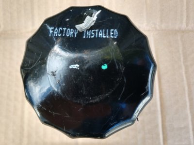

An hour later this is the filter. I always win. Does RAM have gorillas working in the factory?

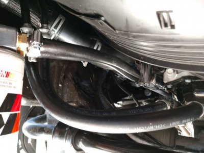

With oil drained and filter finally removed I get ready to install my relocation kit. Most kits include 90 degree connectors on each piece. I didn't want that nor were hoses able to be routed on the Ram with 90's so I pieced together my own kit using Perma Cool parts. All made in USA. The single filter mount allows larger, better filters.
3798 spin on adapter M22x1.5
1711 single filter mount 3/4" x 16 filters (K&N HP-3001 or equivalent)
15156 brass 1/2" barb fittings (2 packs)
131 hose 1/2" x 5 feet
14008 hose clamps (1 pack)

First oil change on all my new trucks was always done by the dealer for that very reason. They must torque that damn filter at a couple hundreds pounds!!!!!

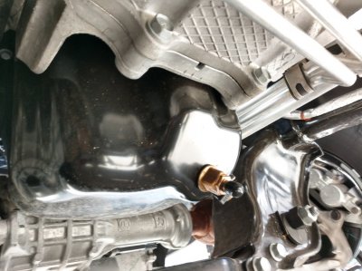

By comparison, the oil drain plug was barely tight. I was expecting gorilla torque on it but there was none.

I don't know about your 2013 but my 2017 you can only get one hand on the oil filter. The electric power steering pump is directly below filter on top of the rack. There is less then an 1 inch clearance between filter and pump.
Unless you are Superman, you wouldn't have got my factory installed filter off by hand.

Made and installed a transmission skid plate to protect Fumoto valve and plastic transmission pan..
http://www.ramforum.com/threads/transmission-skid-plate-homemade.113012/
img_2344-jpg.116086
img_2345-jpg.116087
img_2346-jpg.116088
img_2347-jpg.116089
I know this is old, but was there a reason you made your own version for 50% more cost than other kits?
