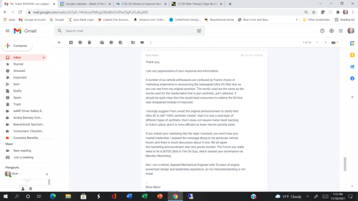

I wrote back to Fram and basically asked WTF is with their marketing on this, and explained why we thought they went to half paper media.

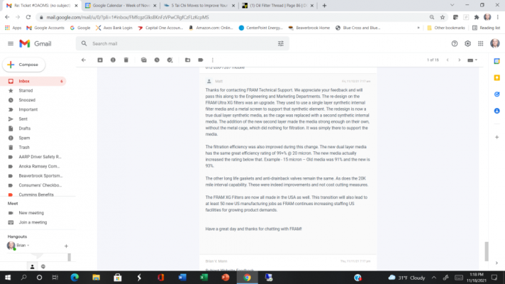

Members -
I sent an email to Fram inquiring about their re-designed XG Ultra Oil Filter. Below is the response. Thoughts?
Ok, I wrote back and explained why Fram's announcement of "new & improved" XG Ultra Synthetic Oil Filter misled us. Below is my letter:
Today I received a response. The Fram guy insists their "new & improved" XG Ultra oil filter remains ALL SYNTHETIC MEDIA, and still made in USA. That's all I know - don't challenge me, this is from the Fram guy - NOT ME!

The second "synthetic" layer made it strong enough to omit the metal screen, well the last one had two synthetic layers as well, what changed about this "second" layer? My question, do they add binders to it now? They would never get this info out, it is up to someone to test it. I will get one for the wife car and test it this summer, maybe someone can do it sooner.
Thanks for doing all this Hemimann.

No, the Fram guy claims the original media had only a single layer of synthetic media, all of one material, which required the metal mesh screen. Don't know if this is true or not.
Again, I'd guess their revised media has a dual density layer, like many airfilters do these days - a coarser outer layer, finer inner layer, that provides longer life via segregating the particulate holding layers. And supposedly, the finer inner layer is stiff enough to not collapse.
So, only the inner layer would be 99% @ 20 micron. The outer layer would be the "rock catcher".

Yeah, that's not true, lol. They were even two colors, maybe not I forget to be honest.
You can put stiffeners in air filters, it doesnt get heat cycles with hot oil in it that changes the filtering ability.
