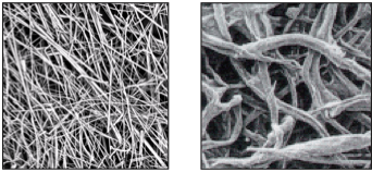

Did they test what is the point when cellulose turns into carb board from heat cycles? We know spun microglass will outlast any oil, I'm not sure the reason to consider paper unless you are on a less then 3 mos interval with less then 3k miles. Every paper filter I took off my ram from transmission to engine oil filter the media was simply stiff as a board, even at 5k miles.
Let's face it the information age is dead, the search for the perfect products is long dead. The PR and Marketing arms of everything from the gov't to the car manu's, it is in none of their interest in keeping engines running smoothly and lasting a long time. Until I see an unbiased test similar to the GM test that also includes lifespans of media and testing all available filters including the best ones made, then I'm not impressed. Flow rates is a good feature, but they couldnt even do that right by omitting filters that we know are full flow. I will stick with what we know about the longevity, flow, and quality of the work we have done after reading the GM test. It is sad that ram forum guys can put motor trend to shame with our process, you would think motor trend could do better, but who are they beholding too?
Why, of course they did!
Durability is their primary purpose - not who wins the quarter mile! :laughing1:

Many assumptions there, have you tried a mopar filter against one of the filters mentioned and seen an increase in psi?
A much better strategy to use a low efficient filter that is glued and in less then 3k miles it is in bypass all the time? Last paper filter I took off my truck will be the last paper filter I ever take off my truck, stiffer then card board, there was no filtering going on there. 2 year oci with RP, the media was like brand new, not a very hard choice imo.
Even when both filters are working their best, which one would you rather have? same magnification one paper one synthetic.
