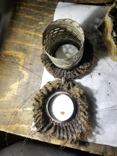

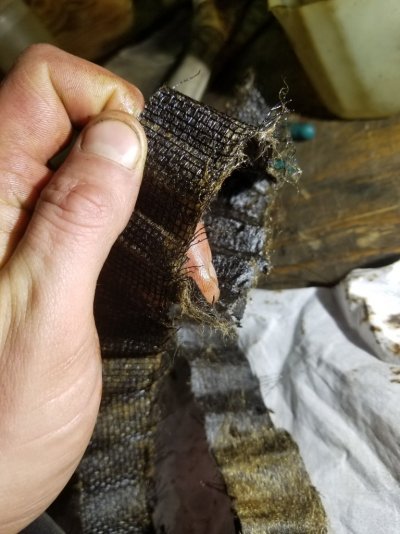

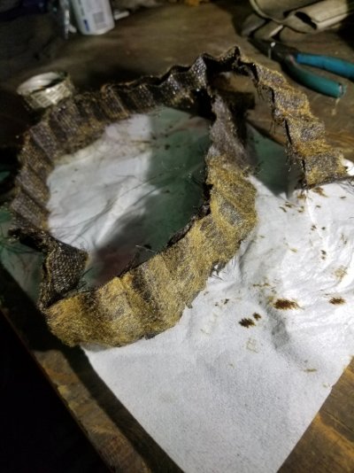

Hey guys! finally got to my ~1 year filter change interval. so this was a fram xg10060 purchased and installed last year 30-04-21 at 5478km (3k miles)
I changed it out with the oil this weekend at 33986km (21k miles) so that makes 28508km (17k miles) on the filter and almost 11 months.
this truck is my daily driver and weekend toy so it see all conditions from -30c to +40c. I also drive it like a hemi is supposed to be driven, I love to hear the exhaust and smoke civics at the red light! no towing this year but lots of hauling and offroading and a few casual drag strip runs during the summer.
honestly the filter is in great shape it could probably go 2 years easy but I will continue to change it every year until its out of warranty or I dont feel like it anymore lol
now for the goods
20220322_115301.jpg20220322_115324.jpg20220322_115626.jpg20220322_115654.jpg20220322_115715.jpg20220322_115723.jpg20220322_115729.jpg

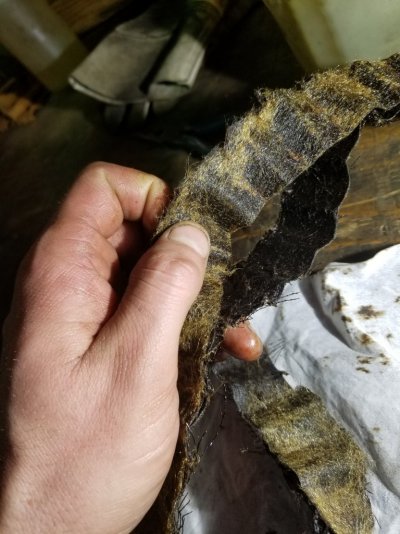

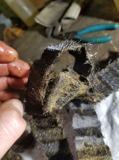

im not sure why the outer layer of fiber appears golden. the interior layer was like felt texture and thickness. the wire backing appears to be nylon wire. silicon adbv was perfect. no varnish or anything at all found in the filter or walls. when I cut my filters on my 06 hemi there was always chunks of carbon grit to be found in the filter
all in all very satisfied and I replaced with an xg2 but this one seems to have been fine. will do this again next year!

This must be the new Fram Ultra design with two layers of filtering media - coarser outer and finer inner.
Much ado was made of removing wire screen backing from the outer layer, and I'm surprised to see a mesh screen in between the media layers. Doesn't look like any delamination occurred, and that's a lot of miles on the filter.
What oil was used? It looks sludgy.

pp5w40 and pp0w30 winter. changed around 4 to 5 k miles. im not really a stickler for exact milages, more whenever I have the time. it starts looking dark around 4k miles thats when I start planning the change lol
