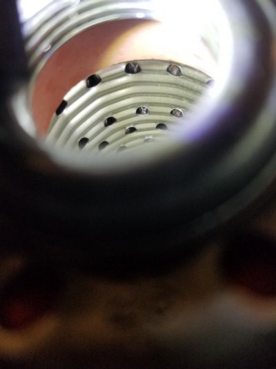

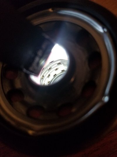

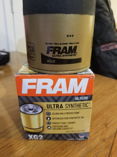

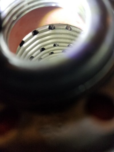

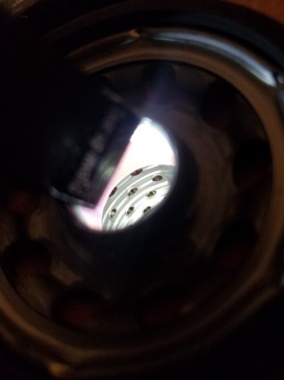

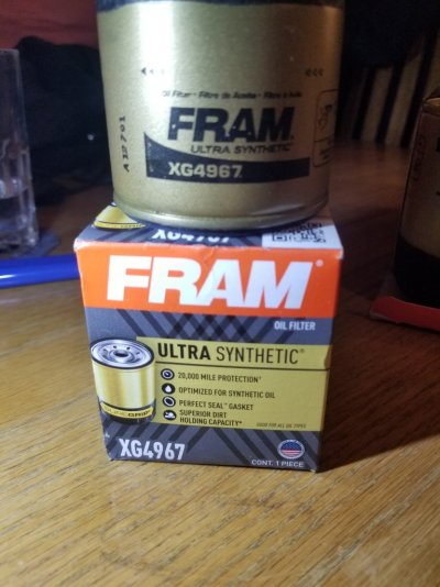

alright guys I bought some new fram ultras on amazon and have some interesting photos for yall
got a filter for the girlfriends Toyota matrix and a xg2 for my truck
they both declare the perfect seal gasket no mention of wire backing
im not sure what order the photos will be posted in so
xg4967 no visible wire backing
xg2 visible wire backing

As expected. These will have Fram's new dual density synthetic medias, where the claim is that together, they don't need wire screen support, and filter finer.

Maybe this is what the Fram Rep. meant by dual layer in his email reply to me?
Quite possibly so. The media seems to be synthetic media atleast based on appearance. But one guy on youtube seperates the media from the polyester mesh backing

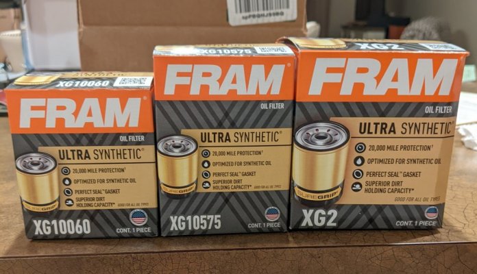

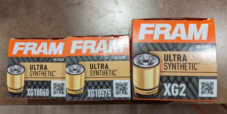

What's the Fram Ultra that corresponds to the larger RP 20-820?? (I know it's probly somewhere back in this thread, but I'm lazy)
Hi. There are 3 Fram Ultra filters that I know of that have the same thread sizing to screw on properly to the 5.7L hemi, along with the properly sized rubber gasket/seal. They are the XG10060, the XG10575 and the XG2. 10060 is the smallest and definitely fits my 2020 1500 w/5.7, the 10575 has same width (diameter) as the 10060 but is taller, and the XG2 is both taller and wider. I don't know for sure if either of the two larger filters will fit my truck. There's not a whole lot of room around the filter.
Top View
There is a Fram Ultra XG16 which appears to have almost identical dimensions as the 20-820,but different threads and different gasket size (will NOT work on 5.7L). The RP 10-48 is almost identical to the XG10060 - that one WILL fit my truck also.
Let me know if you find another Fram Ultra that is closer in size to the 20-820.
Thanks.
John

Thanks. I found an XG2 in my garage...turns out that's the filter that I've been using on my Ford 450! So now I also know I can use the RP 20-820 on my Ford as well. Learn sumpthin new everyday!
