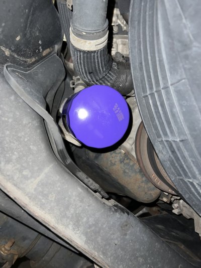

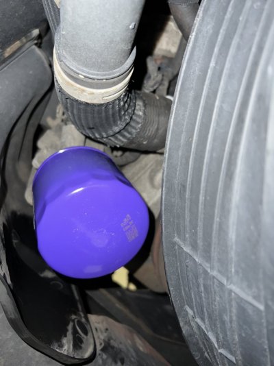

This is the clearance you have on the 6.4 using the royal purple 20-820 filter

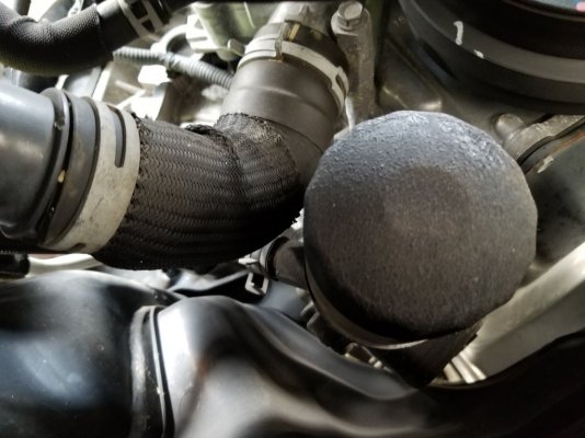

There is no gap on mine, even with the narrower RP 20-500 oil filter. Model Year 2017, built Jan. 2017. It looks like they custom fit every hose assembly? I can't believe their assembly tolerances vary by inches in this day and age of 3D CAD layouts. Then again, I had a CAD Designer stick an engine oil filter into a chassis frame once without noticing.
What transmission do you have? Do you have 4x4?
