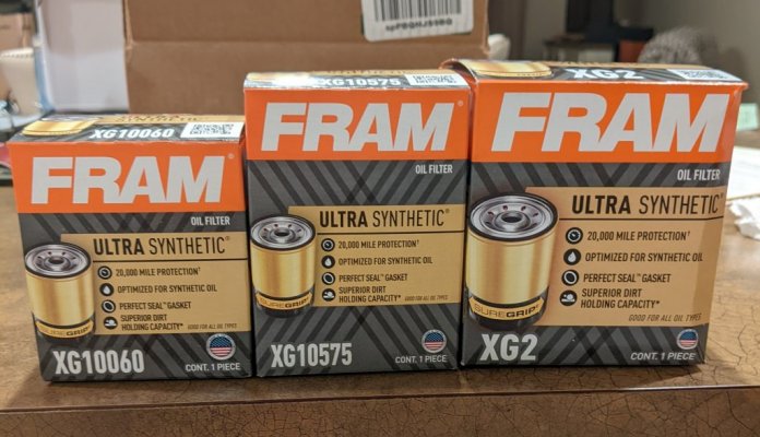

Hi. I took those pics 6 months ago when I was deciding which filter to go with on my 2020 Ram. I bought all 3 from Walmart and returned the two that I didn't use. I went with the XG2 and all is great so far. I change my oil every 6 months (don't laugh too hard) with maybe 2,000 to 3,000 miles on the Redline oil. Yes, w/filter about $94 twice per year, but if it keeps my engine quiet, then well, well, well worth it! I don't want to have a problem (hemi tick) and then say "What if I had used that Redline ...?".

@HEMIMANN, I will look and see if i still have the XG10575, so I can cut it open and measure the media surface area. I don't have an XG2 yet, as its freshly installed on my Ram.
The XG2 definately has a bigger volume than the XG10575 and 20-500 based on can size.
XG2 = 22.879 in3
20-500 = 20.691 in3
XG10575 = 19.030 in3
XG2 can volume is 10% larger than 20-500
XG2 can volume is 20% larger than XG10575
Pending measurement of actual filter media
