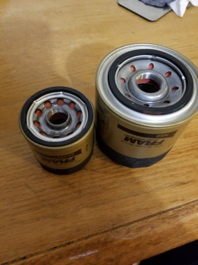

Something to discuss, from hemihustlins picure and ramffml, in search of replacements to the 20-820 what filter of there two would have less restriction? I wonder if fram adjusted their small filter because of this issue? If so, color me impressed. Look at all those holes on that small filter... Maybe I just passed because they were small, my bad I do appologize worth a look.

Wow, the small filter has 10 holes that look twice as big as the 8 holes on the big filter. What the heck is going on there?

Right? Just maybe it used to have less but they adjusted because of some reason?
I likey.

What's the model number on that small fram? Because I also took a picture comparing the Fram XG10060 (what actually "fits" our hemi's in the online catalogs, comparable in size to RP 10-48) and the Fram XG2, and there are only 8 holes in the XG10060:
