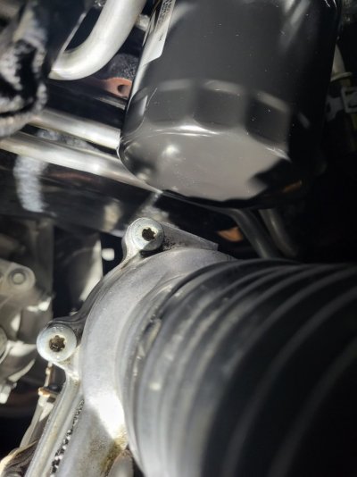

I will see if I can make it out, ask hemihustlin. Brian was correct.. can that fit a hemi?
As far as I can see, the XG4967 is even smaller than the XG-10060 (and RP 10-48). I wouldn't use it?

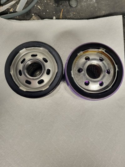

Put on the Wix 57899XP, plenty of room at 3.75" tall. 1/4 inch or so gap by transmission cooling lines and 3/4" before hitting the rack. Not sure why I didn't think there was enough room before with the SRT filter. If the XG2 is 4" tall it should fit with about a 1/2" from the rack. After seeing the small inlet holes again on the 10-48 I don't know what I was thinking using that filter, it's obviously restricted, here's the OEM 339 for comparison 20221202_225615.jpg

Put on the Wix 57899XP, plenty of room at 3.75" tall. 1/4 inch or so gap by transmission cooling lines and 3/4" before hitting the rack. Not sure why I didn't think there was enough room before with the SRT filter. If the XG2 is 4" tall it should fit with about a 1/2" from the rack. After seeing the small inlet holes again on the 10-48 I don't know what I was thinking using that filter, it's obviously restricted, here's the OEM 339 for comparison View attachment 508169
Well, you're trading one hypothetical problem for a real one. The RP has smaller inlet holes, why are so sure it's not enough flow?
On the other hand, as far as I can see the Wix only has a 99% effiency rating at 35 microns, vs the 99% at 25 microns for the RP so you're not catching as small particles with the Wix. I'd be more worried about that, given the lifter tick issues and how sensitive those needle bearings are to small debris getting in there and seizing up.
?View attachment 508171
right? Picture is worth many words they say. I had hemi tick because of a center tube with not enough holes, similar like you I posted it. It is beyond me why companies don't make stuff like they should, I'm sure those holes are stamped and it wouldnt cost more to add more holes. Just people ignoring an important function of an oil filter, not not obstruct flow is any way.
I'm pretty sure he is correct on flow as the cousin filter had a technical service bulletin on it saying do not use it on a hemi. I also agree wix xp is one of the last choice imo, but I'd take a wix over a flow issue any day of the week.

The Wix is temporary until 20-820 are back, lord willing. If not then Fram XG mid or large size.
The tick increased with the 10-48 and was borderline non existent when I had the small 57060XP

Makes you wonder if the 10-48 had 8 holes to start with would we even know there was an issue? Especially if those 8 were large like the other filter. Even with top filters we have to chose what evil we want to live with, so freaking dumb.
That Wix 57899XP still has 6 inlet holes, slightly larger than the RP 10-48, but still smaller than the 8 holes on the Fram XG10060. But the Wix body is larger so it may be a trade-off.
