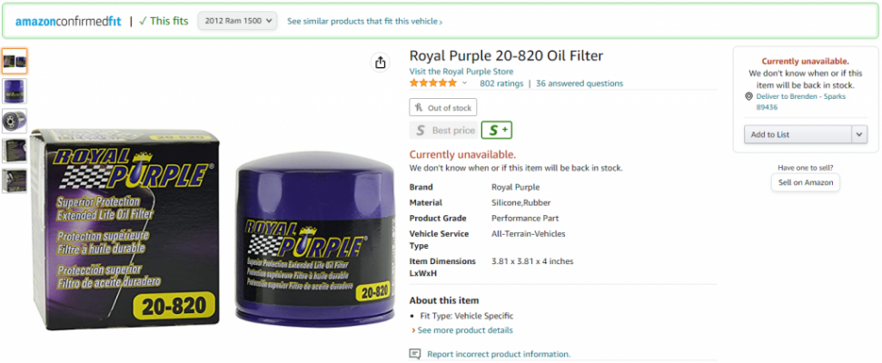

Apparently good news, Royal Purple 20-820's are set to be in stock feb 6. Amazon is now taking pre orders. If this is your filter, I'd stock up they will store well, I've stocked this exact filter since 2017, but other canister rp filters for a decade and you cant tell they werent new. My guess the media untouched will outlive you. Someone must have told them they will be in stock or why would they do this? I do this all the time with amazon, and they have always sent the item eventually. I have another item like this they keep updating me sooner ship dates.
well damn they already shut it down, lol...
Interesting. I show it is still same state as before. Not giving option to order
