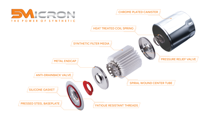

Btw, here's the construction of PGI (Vietnam) I use in Harley. It appears the same in my inventory, no need to cut open. I can see the wire mesh and the white filtration media. Heavy gauge canister, etc.
But they won't make this for the auto market, unless Carquest EP is it?

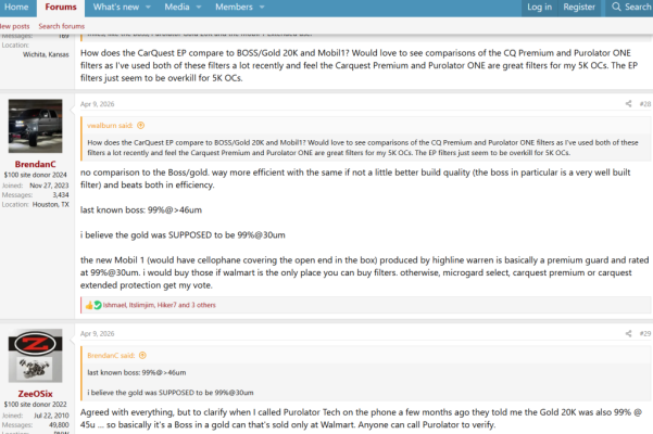

More recent on Bob's: April this year. Boss is a rock catcher. CarQuest is PGI, advice is to go with the 10,000 mile "Premium" and forgo the 20,000 mile "EP"........apparently they loosen the efficiency of the EP to gain more dirt capacity in the same size can. When I'm out of legacy Fram FE and Royal Purple oil filters, I will go to CarQuest Premium. By that time, there may be no oil filters left in the world that are any good.
Brendan is a lube guy also on Harley Forums...
