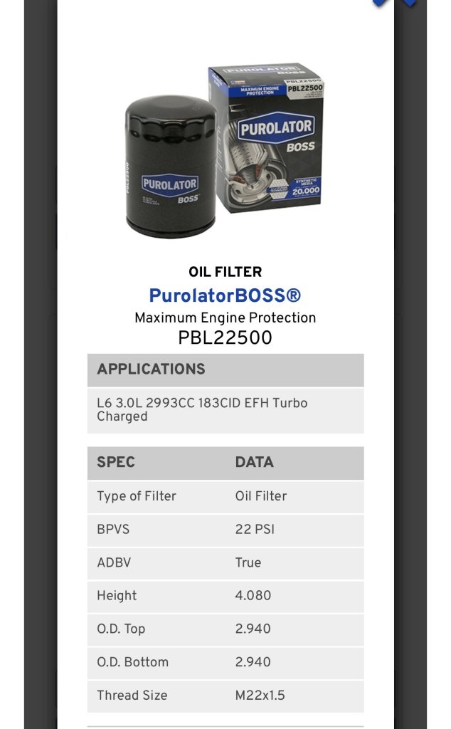

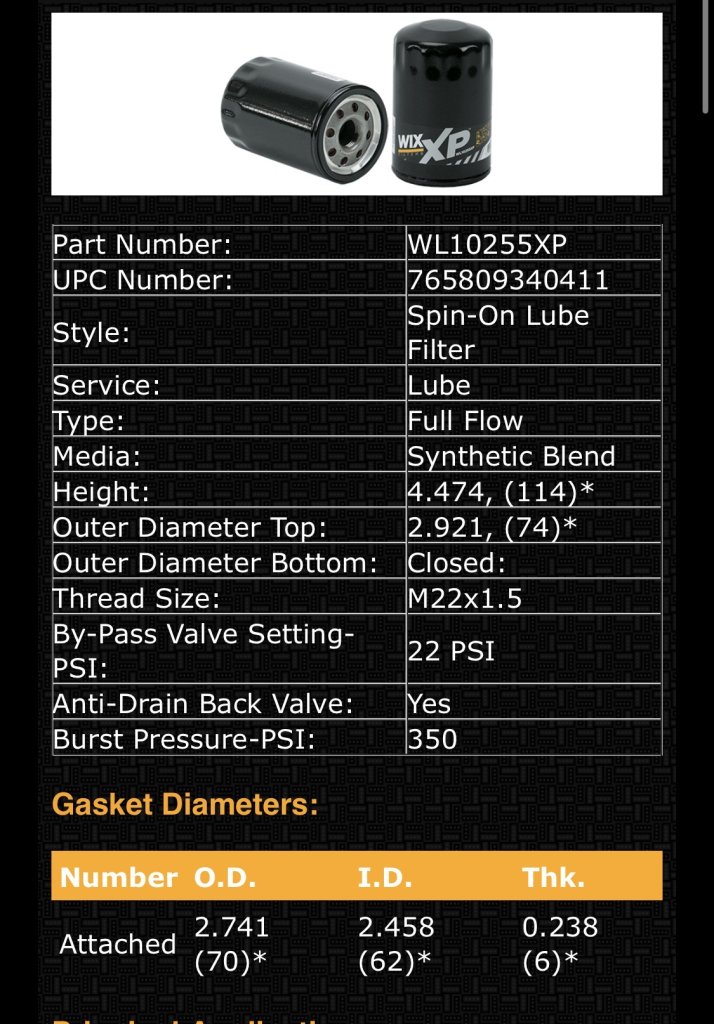

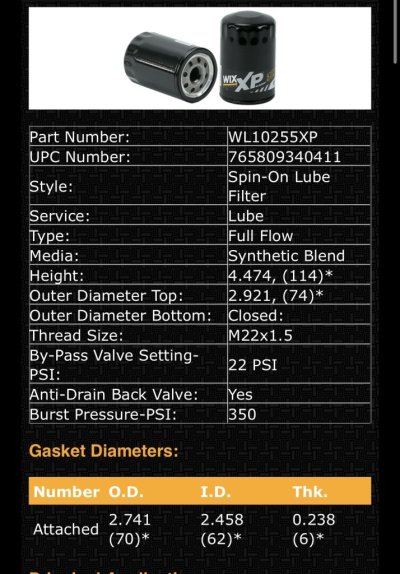

Seriously though, on my 2500 mile earl change I used the Purolator Boss PBL22500 and it’s a few inches shorter than the OEM Mopar filter. Getting close to my 5k OCI and looking for some guidance. Are there any issues with a smaller capacity filter, or should I look for another brand? What about the WIX XP? It looks to be more along the same size of OEM. IMG_4779.jpegIMG_4780.jpeg

GeauxinUp I think most of us by now would advise to use the largest filter you can. Why? Hemi is marginally oiled due to low low idle (to save gas :rolleyes: ) and of course the lifters and cams not being properly oiled.
So - anything to keep flow restriction down while efficiency up is the answer. Which is why we want all synthetic media with the largest surface area.

Not that in necessarily matters in regards to your point, but I have the HO Hurricane. I’ll go with the WIX XP. At least it’s a synthetic blend media. Thanks!
