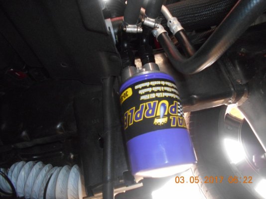

Stay away from the Pac Brake kit,as it might be well made,but it's a very poor design. I started with a single filter relocation,then moved to a dual filter set-up,that uses big ole 30-8 Royal Purple filters. The dual set-up is superior to the single set-up,as i gained oil pressure when i switched to dual filters,and oil temps went down
Rick, any help with links or who makes that kit you're using?
It's a modded 1227 Transdapt kit Mike.I upgraded it to -10 (5/8") hoses and high flow fittings,and i ported it by rounding off all the sharp edges i could get to with a die grinder and carbide bit. I hate sharp edges in the oiling system,lol.
In hindsight i'd just buy the filter adapter and the relocation mount,and then make up the hoses.

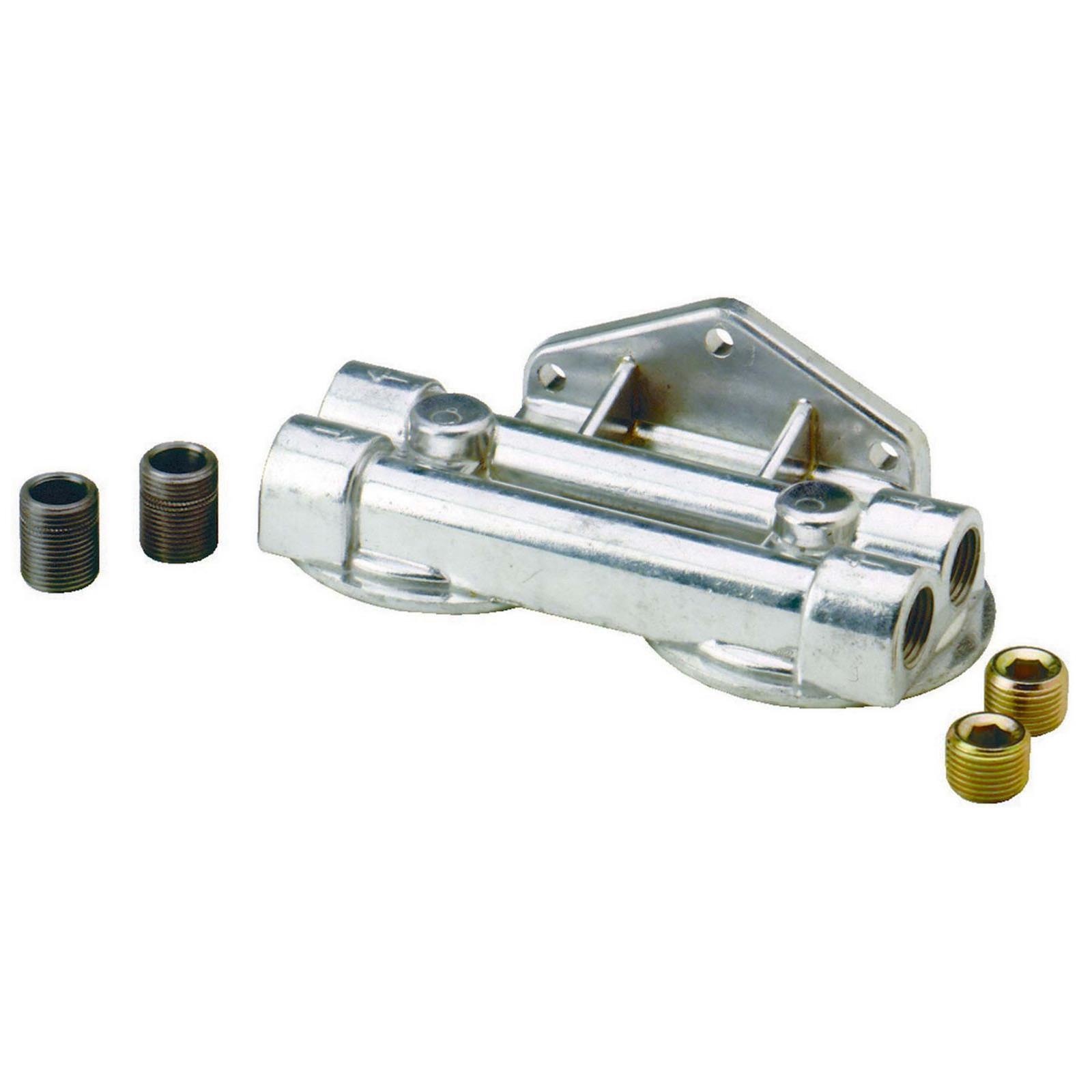

If you wanted to stay with a 22mm X 1.5 filter this would be the one to order.Not sure why you'd stick with the 22mm thread pitch filters though,as there's more 3/4X16 filters in a bigger size filter

Thanks Rick! I've used the single filter Transdapt kit in the past. It works fine but my biggest concerns had to do with the hoses. I never say any difference in oil pressure with that kit though.
I started with the single kit,and it wasn't till i went to the dual kit that i noticed an increase in pressure Mike.The single kit was basically identical to the stock filter even with the bigger 30-8A filter

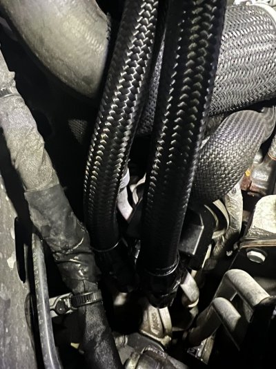

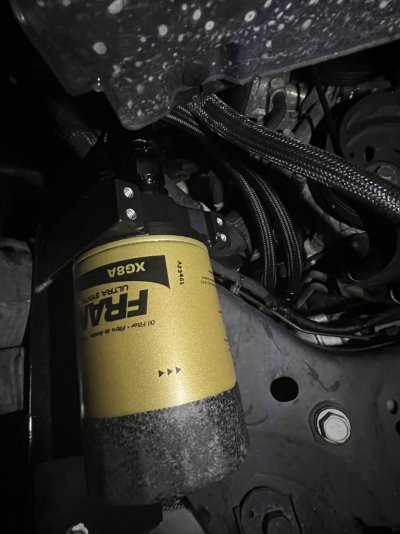

I used Derale parts and made up my own kit. I went with the single filter setup and as others have mentioned, my pressure and temp stayed the same. Definitely considering a dual filter, now that I’ve read here about the pressure increase and temperature drop.
Take a die grinder and carbide bit/cartridge roll etc,and smooth out as many sharp edges as you can get to.Sharp edges and oil flow don't go hand in hand :waytogo:
