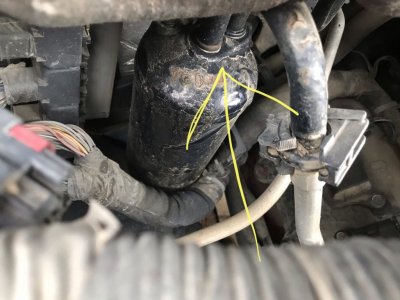

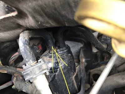

Have a leak in the metal canister located on the firewall passenger side. What is this canister for?

Thats your A/C dryer, If ac is working good, leave it alone, to fix it , the system has to be evacuated and reclaimed and a vacuum put to it before you can change it.
