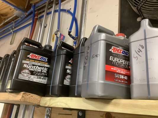

You won't hurt anything with 5W-30, and it will reduce wear if you tow frequently. Many of us run 5W-30 regardless of which Hemi we have (I have the 6.4L for which they spec hellcat oil 0W-40, which is overkill for the truck - I'm not racing the truck). The only impact some guys have seen is maybe a decimal point or two reduction in fuel economy. Not a big deal. Not to mention odometer mileage could possibly image.jpgland you in 5-40 land
