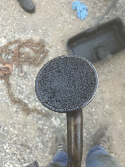

Possible clogged screen o oil pickup tube , may have dislodged debris from forced oil pressure.
Seems to me like it’s time to drop the pan for a visual inspection.

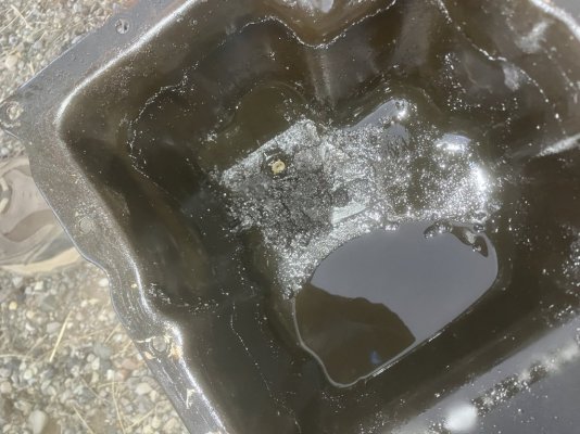

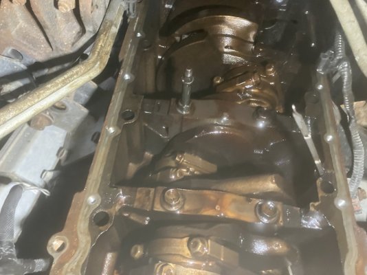

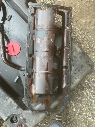

Dropped the oil pan and went to replace the oil pump, found about a cup worth of dried sludge like material in the pan and the pump was caked in that material as well as the underside of the engine. The pick screen was packed with material. There was no metal in anything thankfully. Unsure what to do next. Im assuming that there are large amounts of material still in the engine. Not sure if putting it back together and run multiple flushes through it to try and clean it. Or if there is another option that works better.
