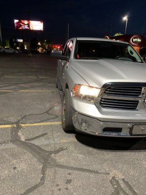

What grill is in your truck. A lot of guys don't realise there is a big difference in air flow through the different grills.The Sport style grill is very restrictive compared to the more open honey comb grill. You can pop out the middle shutters pretty easily,they just clip in on the ends and will pull right out if you flex them in the middle,they'll also pop right back in reversing the procedure. Pull the middle shutters out and see if it makes any difference,if it doesn't re-install them,but it's worth spending the couple minutes popping them out to see if it changes your temps any.
Mine is this one. sorry for the half pic. Was trying to capture a wheel spacers from this pic. Don't thinks it's sports. However I think it also has a middle section but not sure if it's honey comb.
Jan 17, 2016
23,632
54,258
14 Sport
That's the ****** grill,lol. Look at it close,and you'll see it's very restrictive to airflow,(little holes between the chrome slats),then go look at a cheap Tradesmen/Express grill,and it'll be very obvious which style grill flows more air
Yes, style over functionality. Sometimes the engineer over at Ram get veto from the marketing/style department so they can sell trucks. Do you know if the middle section can come off easily?
Jan 17, 2016
23,632
54,258
14 Sport
Yes, style over functionality. Sometimes the engineer over at Ram get veto from the marketing/style department so they can see trucks. Do you know if the middle section can come off easily?
They just pop out the back and you can replace them with the honey comb inserts. You can get the honey comb inserts in either chrome or black.I don't think they are even that bad if you buy them right through the dealer,but i'd hunt around first,and if nothing pops up,then try the dealer,lol. You need the inserts for a 2013 and newer truck,the 2012's and older use a different insert
Just cut like one of those sections out in all 4 slats, I would. That is a terrible grill, lol.
I'd just get an aftermarket grill, might fix this issue over night.
