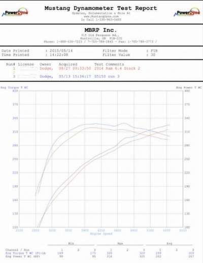

Regarding the dyno, this is what was provided by MBRP on another forum. Before everyone jumps on this as well understand it's a Mustang dyno. Which means it almost always reports lower numbers then a Dynojet, which is the most commonly used.
As soon as I can get time scheduled on a local dyno I will post my own. But with headers, catback, tune, etc. I'm obviously not going to provide a useful baseline. So for now, the MBRP dyno is all I have ever come across.

Manufactures dyno, not a third party. Talk about derailing, its way off the track now......
Since ram hasn't release a dyno for the 6.4, why who knows, here's a comparision for a unbias manufacture. Notice the difference.

Since when do manufactures commonly release engine dyno charts and who would ever believe it if they did? The entire aftermarket and enthusiast community, except you, relies on "third party" dyno results to verify a motor's output from manufacture claims.
