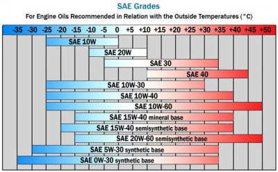

Some flow rates on oil.
Well ****. I’m in az now, my truck will rarely see 20 degrees let alone anything colder, But I gurantee in the summer outside air temp will be 120 to 130 F. Maybe I should run a winter Weight and a summer weight.
Also this 5.7 with the 8 speed runs warm, consistent 215 degrees for the most part.

A good 10W-30 synthetic will serve you well. The 10W cold rating will do fine in any temperatures Arizona can muster in the cooler months. Typically 10W-30 synthetic oils have very little to no viscosity improvers too, so shearing will be very low. Mob 1, PP, or PUP if you can find that grade, Redline, or Amsoil all have very good offerings.
