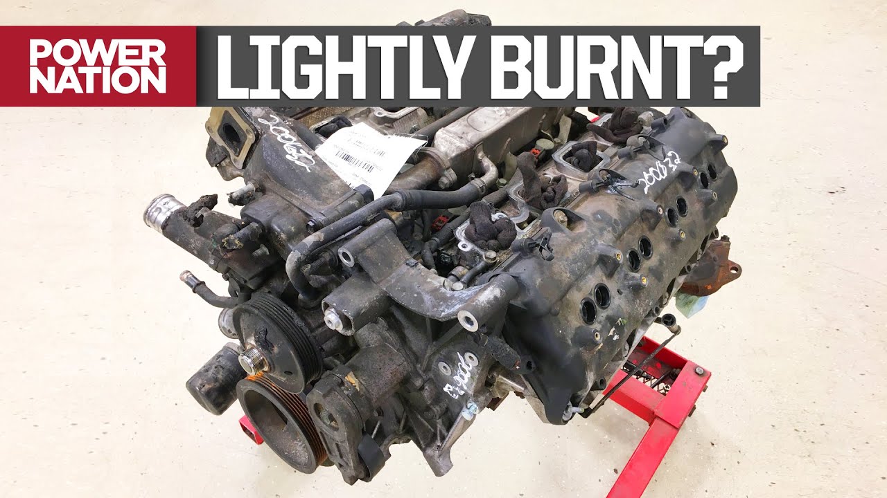

Where exactly does one find a "burned up junkyard" 6.4L? I'm in!
