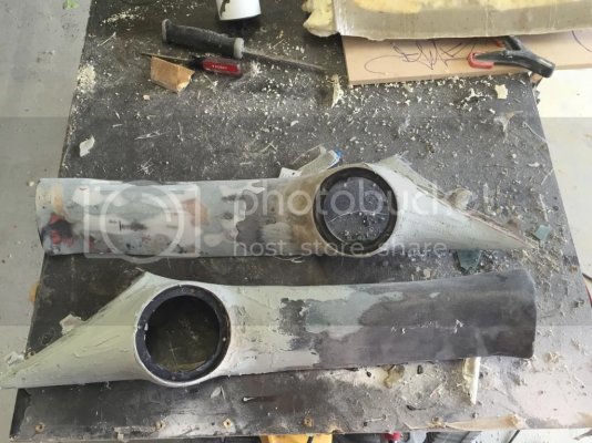

Also I finally got off my lazy **** and got some work done.

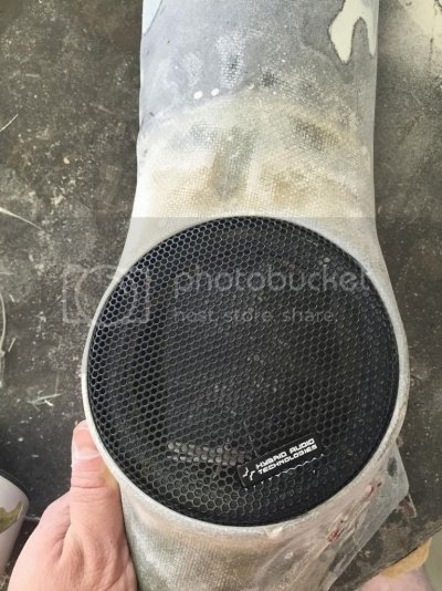

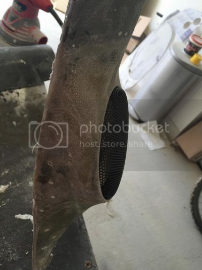

Stretching fabric rather than hand forming foam gave me much smoother and straighter lines
After a little cutting and sanding, you can see a much nicer fit and finish than before...

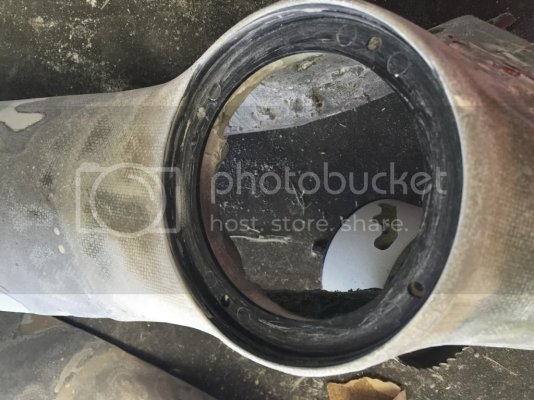

Now that brings me to the next issue... When I wrap it, I would have to tuck the fabric in there and the grill won't fit. So my options are to sand 1/8" or so from inside the ring or just paint it. I could texture coat it, like my sail panels, and probably find an identicalI color paint. Although I really like the suede but in order to make it work, there would need to be a seam in the fabric and I just don't know if I'm good enough to pull that off and still have it look decent. I'll have to sit on it for a few days. What are you guys thoughts?
Anyway, another round of sanding and some spot putty, and these should be ready for finishing.
