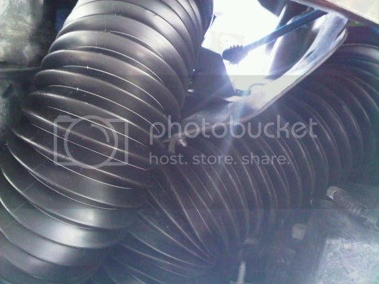

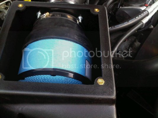

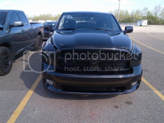

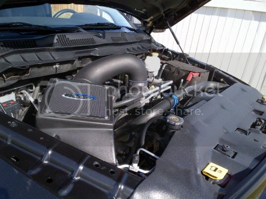

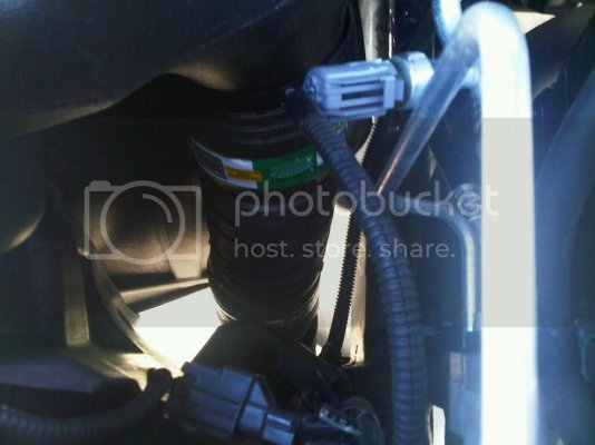

Been there, done that! several times...
Lucky to pick up a 10th of a second over a quarter mile
(track tested for well over 300 passes on several intake systems over 4 years)
Dual 4" feeder tubes to a Volant CAI
One 4" tube ran to the opening in the underside of the Volant air box
The other tube ran to the stock air box fender opening. (over double the size of the throttle body)
the Volant powercore filter is so efficient I measured no difference
whether the filter was installed or no filter at all for several passes.
You're totally wasting your time (and money) if you don't also have catless LT headers ;)
IMHO, The only way to Ram more air into the intake
that will make a significant measurable difference is forced induction...

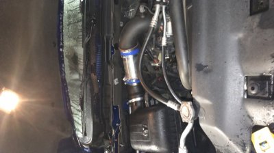

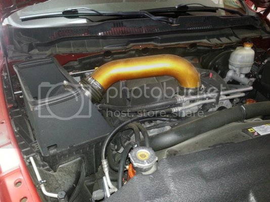

this is what i ended up doing sorry for the sideways pic like i said i wasnt done with it...

Much better than your WAI. You can also do the airbox mod to allow a bit more airflow for just a few dollars. Plenty of DIY pictures floating around. Most run a 3" or 4" tube from the bottom of the airbox down to the foglight area. Couple it with a quality aftermarket drop in filter and its pretty much just as good as the S&B or Volant.

thats what i thought but people jump down a guys neck on here so fast like holy hell but yeah its all good
