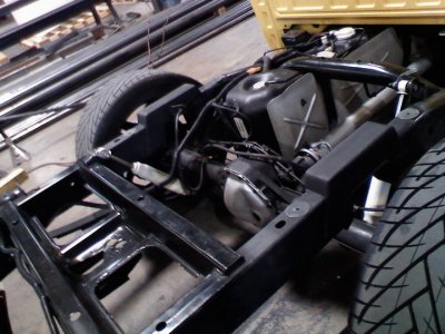

dont be scared to cut on the frame a lil lol my noch on my truck is about as bigg as u can go without having to cut the bed :roflsquared:
ride so much better on my 2/4 i will never bottom out now and i made it out of 3/16
Armor plate so it wont bend when i get rear ended :naughty:

that looks awesome

Yes that is nicely done.
I was thinking using the heavy wall pipe and a piece of 2x2 square tubing on top of the frame.

We made that notch at the place we work. We both work at Integrated Armor and build armored vehicles. We have access to a CNC plasma and the CAD program to design anything. We also build Ranch Hand style bumpers so we also have access to 4.5" OD tube for regular old school C notches.
The one on Coleys truck is called a "super C" and fits .250" under the bed floor. It slides down over the frame and then welds in so you dont lose any strength there.
