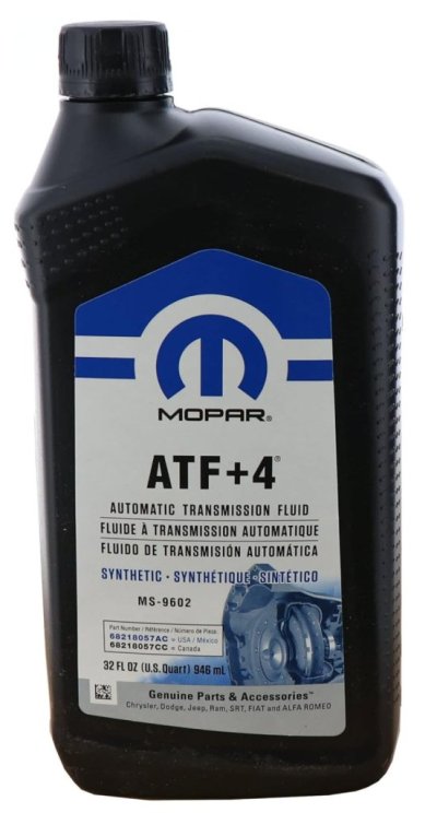

I order 1 quart of Mopar ATF+4 MS-9602 from Amazon and yesterday i got the package with a quart of Mopar CVTF+4 05191184AB Instead, so i return it back today but yesterday i re-order from the same seller again thinking that maybe was a mistake or something but today i got the same thing again. I don't think this is the right oil for me the CVTF+4

Don't think so. That is for a constant variable speed transmission
  • Type: Fluid for Continuously Variable Transmissions (CVTs).
  • Part Number: Commonly listed as 05191184AB or replacing 5191184AA.
CVTF+4 and ATF+4 MS-9602 are not interchangeable; using the wrong one can cause severe, immediate transmission damage. CVTF+4 is specialized for Continuously Variable Transmissions requiring high friction, while ATF+4 (MS-9602) is for traditional step-gear automatic transmissions

ATF+4 is licensed to many oil manufacturers, and you can buy it at any parts store.
Seen Penzoil atf+4 at Napa and also they napa brand and Valvoline atf+4 and i guess those should be ok?
Yes. ATF+4 is a licensed product and must meet specs to be called such. Alternatively you could go with a well known quality 'universal' fluid like Valvoline MaxLife.

Walmart or any auto parts store will have a licensed ATF+4. Castrol and Valvoline ATF+4 should be available pretty much anywhere.
I would not get fluids from Amazon unless its the brands storefront on there. Even then, I don't trust Amazon for critical fluids like ATF.
Thank you for that info! Appreciated
Thanks for reply and clarification.
Got this one here
and has 5 star and of course different seller and should come Wednesday
Anyway lesson learned with this for next time.
