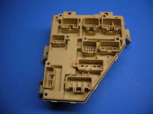

ok, i couldnt get a picture behind the dash, to much crap in the way. but i pirated a picture of the back of the fuse block. ua0W4w8.jpg its the top right plug in this pic , it will be a brown colored connector.

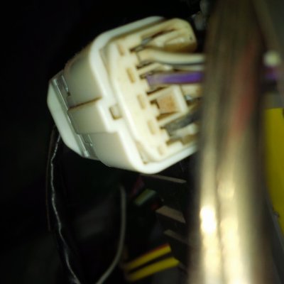

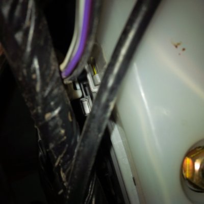

ahhhh, the white one, yea, give me a few minutes to get a pic of it.
BeauDuke01
BeauDuke01
Jul 10, 2012
426
158
2001
5.9
ok, its to the left side of the white box on the steering column.
its a small flat connector with 4 wires.
really easy to get to, compared to the other pain in the ass one. let me know if you have any other questions. i'll do my best to answer them.
