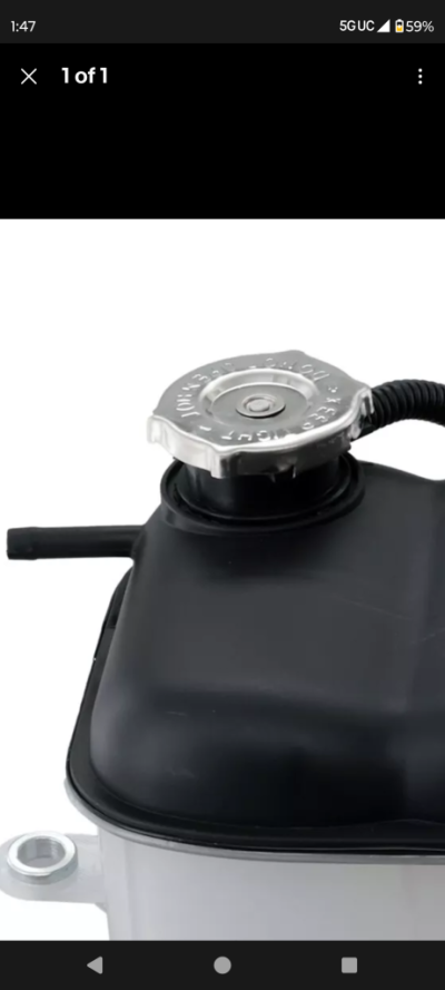

A Google search shows that a 2003 4.7 uses this setup:
That reservoir pretty much uses a normal 16psi radiator cap. About the only way I could see that cap being blown off by such a small amount of pressure is if the plastic around the filler neck were pretty badly damaged.

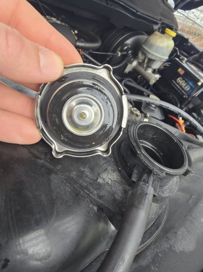

Cap appears in good condition at a glance, the plastic on the reservoir itself appears to have been chewed up a little bit how ever it still has a substantial amount of plastic that that cap locks on too. I don't have tools to pressure check the cap and I believe the cap is rated for 15psi before venting. How ever it has now been found laying on the reservoir twice.

That filler neck looks pretty chewed up. That tank is a pretty cheap part to replace. This may be a good opportunity to flush and clean the coolant system with some CLR or RMI25, then do a refill while also replacing that reservoir tank and new cap.
