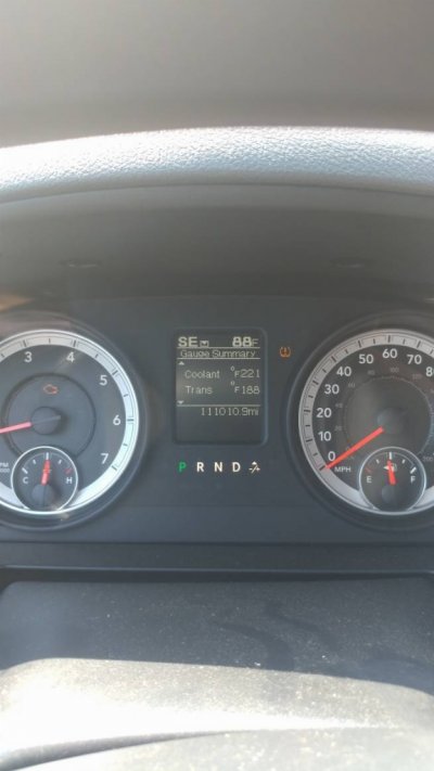

I am have overheating issues with my 2013 ram 1500 4.7 6 speed transmission. At first it started in a parking lot with whoosh noise coming from the fan clutch area. It started overheating to the point it almost reached 3/4 on dial. Have changed about everything and have spent over 400 at the dealership for diagnostics.
Parts that have been changed:
fan clutch
Water pump
Radiator
Thermostat
Electric fan
Dealer put in their coolant.
All Spark plugs changed and some coils due to a miss fire code that does not come no more.
Drove it this morning after electric fan had been put in and still overheats. It will get to 221 f and tranny will get past 180 f. I have another of the same exact ram, and under the same conditions engine will get to 212 at most and tranny at 158.

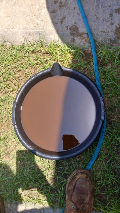

check and see if they used the correct coolant. wouldn't be unheard of for a new thermostat to defective right out of the box. could also check the pulleys and make sure they are spinning as designed, esp the water pump pulley. also start with the simplest check. make sure the proper amount amount of coolant was added.
I checked the coolant and they didn't perform a flush like they said. Have already flushed it out.
In the beginning i didn't know what type of coolant so I put in hoat. Didn't drive it for that long when I took on to the dealer. They blamed it on me and said they would flush and add the proper coolant for 260. Now that I flushed it I found it mixed.13de0069fd0b7465208f7a09ec0a461b.jpg
Sent from my LG-H918 using Tapatalk
That looks dirty as ****, didn't they already"flush" it, I would ask for my money back and do the flush your self buy the correct coolant while your at the dealer.

Sounds like The flush helped assuming the coolant was as dirty as the one you showed us in a picture earlier. With that said perhaps your engine runs a little cooler in general than my 3.6
