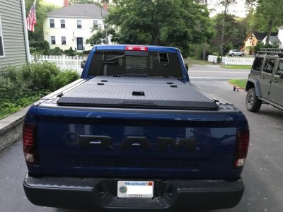

I don't have a rambox but I am on my second truck with Diamondback HD.
1) You can open the tailgate with the lid closed and locked on mine.
2) Mine is pretty waterproof. Pressure washing can get by the seal but rain not so much.
3) Saw that custom backbone rack and that is by far the best looking headache rack that I've seen that mounts on top of the lid. Looks like it should be strong as well.
As I said, I don't have the rambox, but I would think you could mount a headache rack that you like and get creative when applying the seal. In other words, headache rack mounted to pickup bed and not the cover, and adjust to clear. May have to replace the cleat tie downs closest to cab with L-Track or something. I am currently looking at this option. IMG_20180322_181904986.jpg
