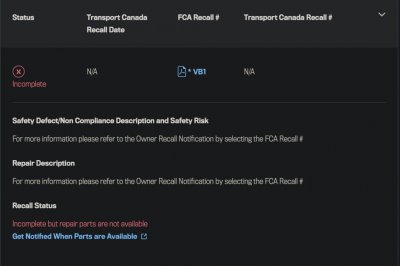

It popped up in my recalls for my VIN today. The VB1 link goes to a "not found" page so far, and says parts are not available yet but the ball has started rolling I guess...
same info here, (was not there Friday)
Remedy TBD (my guess replacement part, and software update)
