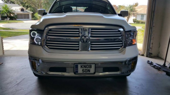

Limeybastard
Limeybastard
Jul 25, 2015
1,872
451
Shady Hills, Rednecksville Boro, Florida.
Bizzare, I just turned on truck to back out and take halfway pics of light install and i scrolled messages. Messaged read front turn signal out and it started to hyper flash LOL. Then cleared up and message gone?
I'm going to remove the two wire splicers I used for the parking light and turn signal and solder instead.
280e1b73147dc7ae20387fae75585330.jpgb9e72055d09a15cc7561f3d13ce9d1ad.jpgaa06f1c6760d51fc0c0ca1fd80b7da10.jpg
Sent from my SM-N910T using Tapatalk
adurm
May 28, 2015
1,218
227
FL
2015 RCSB
Great job!!! Looks awesome! What model truck is that?
