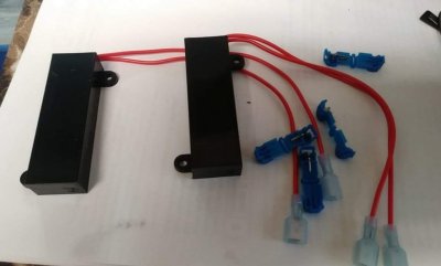

What resistors did you get ? Picture of them ? I ask because if you get the plug and play ones you can mount those to the frame since they are long enough to keep away from the house and any wiring ....

You wont have to cut or splice into anything with these ..you can also look for some on amazon they have a few to pick from ....

Thanks. Seems like those take up alot less space too.

Yeep .. you will be able to zip tie them to the frame away from everything ... this is why I am so turn off by alpharex now ... great lights don't get me wrong but this is the kind of issues should be fixed by them from the get go
