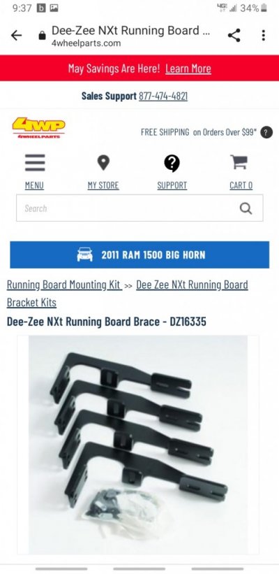

next is the frame attached boards, has anyone used the brackets below? Do you recommmend it?

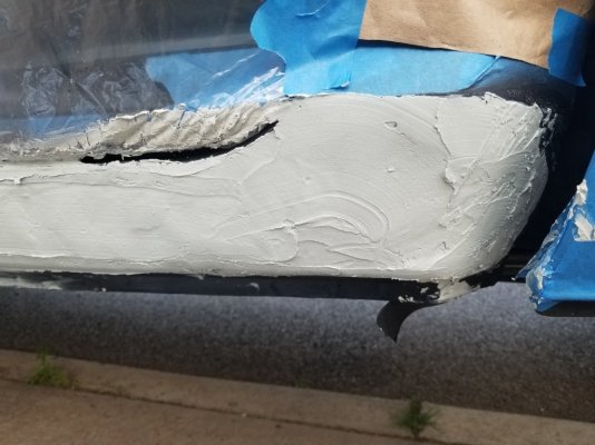

Hi and thank you all for your replies. Simehow I forgot to enable notifications, so I am just seei g your replies. I went ahead and cut off all the rusted parts, spray inside and out with rust reformer and added the mesh with foam. This is now my second coat of bondo. Not sure if I will need the spray filler I bought. Once it.looks.nice, I am painting the whole rocker panel with rugged black paint. The on to the other side.

Also, there are several drain holes, but they all have a rubber plug in it. Should I remove the plugs?

you should have put a add in you local FB groups for a backyard body man... They probably would have patched it up nice and it would have outlasted the truck.. Buddy of mine just did that and had rockers and cab corners replaced and color matched for around 2g and this guy was a retired professional. The patch you did will last a few years and be much worse the next time especially with the spray foam that you added in their...

I wish I had seen the comment about not using the spray foam before I did the job. I used a GE. Rand that says waterproof, not sure if that helps. I called someone and they quoted $350, but I am a hands on guy and skeptical of discounted service. I will try without the foam on the other side. Anyway, money is very tight now. In few years I hope to afford a professional job replacing the entire rocker panels, or a newer truck. Thank you all!

Was that just bondo or fiberglass filler? Bondo will probably bubble pretty quickly - at least in my experience with it.

That foam is going to trap water and salt, and you're going to have a worse problem in less than a year. You would be better off pulling that all out, doing your own sand blasting followed by a good metal primer and paint for cleaned areas, then buying a replacement rocker panel and pay someone to weld it in, then fill and paint. All that including buying a sand blaster and compressor plus panel and an hour of welding would be well under $1k and it would give you the compressor and blaster for future use.

I commend you for doing it yourself,but,that being said,the foam is going to trap water/dirt,and bondo absorbs moisture,so,unfortunately,your repair won't last long.
At least pull the rubber plugs and liberally spray Fluid Film or something similar in your rockers,let it drain an hour,then reinstall the plugs

Thank you, I hear you, I sprayed rust reformer inside the panels, before starting any of the work. it Was a fun experience doing body work for the first time. In a year or two, I should afford to properly replace the panels.
