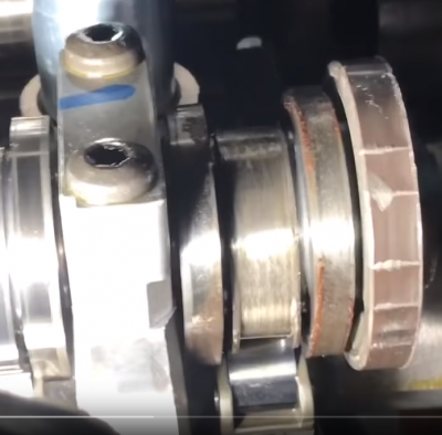

Had this truck for a month. Bought it from a Dodge dealer. Took it back for lifter noise. Declined to repair. I got a 90 day/ 3K warranty. I am going to replace them myself. What is a good source for parts, and any decent info out there that I could look over? Thank-you, Nick

Did they pull the valve cover and look at the overhead cams? Do you have misfire?

I would at least wait for the 90 days? Many guys on the board have been able to silence the lifters with a lubrication strategy, do you want to try that first? Have you ran the codes? No misfires? running rough?

I passed on the extended warranty. They gave me a 90 day 3000 mile warranty. It states it covers 'Internally lubricated' parts. I bought it on 10/3. I haven't heard from the manager yet so, not sure why it is declined. No codes, no misfires. VERY loud tapping from valve covers.

On the pentastar the rocker roller or whatever it's called can fail. It'll eat up the cam too. If they put a warranty on it for internal engine this should be covered. Maybe consider small claims court if they continue to deny it?

Good news!!! They had a change of heart. Got it back today... They replaced intake & exhaust cams, 12 rockers, 12 lifters. Nice and quiet. Once this started, I started reading, it is amazing how many different vehicles this engine is in & how long this problem has been going on. It's no wonder they didn't want to fix it, the bill was 2400.00.
