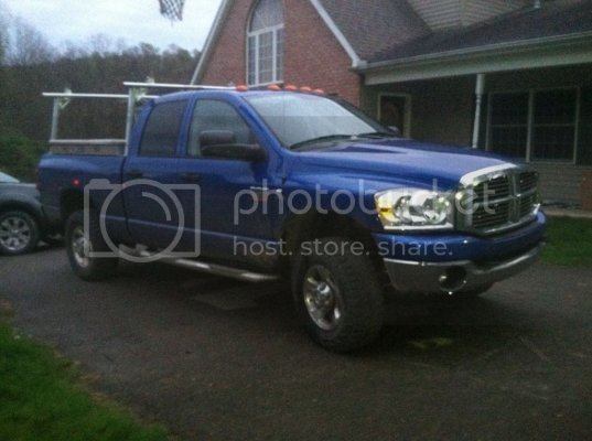

H&S tuners are the top tuner for 6.7 IMO!
Never had a single problem with it in two years now (it has never even been updated)
They run about $1000 with a pyrometer(talk to ramhunter I believe he carries them now)
They have other tuners then the mini maxx as well, the mini maxx comes with a small screen for a gauge read out and ability to tune on the fly so you knock out quite a few things with it
They have a couple different default tunes loaded to them, with a dpf (stock, 40hp, 80 hp and 120 hp) and without a DPF system ("stock" which feels nothing like stock when the dpf was there, 60 hp,120 hp and 175 hp)
It will do the ECU fooling to make the truck think it is always in active regeneration
2010-2012 6.7L Dodge Cummins - H&S Performance
The valair clutch dual disc organic sounds like it would be perfect for you as well
With most kevlar and ceramic clutch that you typically see, that grab really quick which makes backing up hard and just towing a pain
The organic faced clutch is designed for a daily driver who still tows with there high HP truck (they really arent ment to be used in pulling trucks/drag racing)
They are designed to handle 550 horsepower and come with a new flywheel and basically all the other week links in the G56
Theyre around $1200 but well worth the investment already having the tuner
Other then the mini maxx w/dpf delete and the clutch thats all the truck has and it runs like an animal with 95k+ miles on it
Obviously a pretty heavy load haha
Sorry if I skipped over anything you were looking for, I'll be keeping an eye out in case you have any other questions
