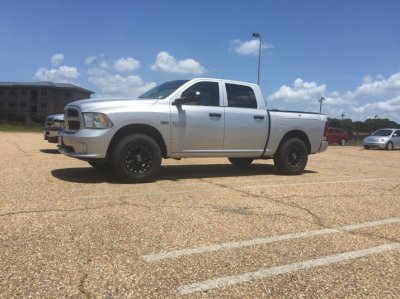

If you are referring to just leveling as a 2 inch lift I have Bilstiens at 2.1 and 33 inch Toyo at 2's

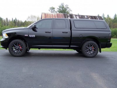

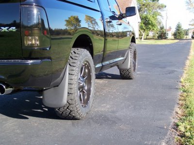

305/55/20 Duratracs, Bils set at 1.4"

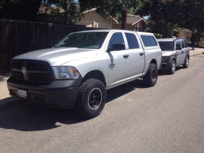

I just shared my new wheels on another thread but here you go. I went 2.8 bils 295/70 r17 (@33/11.5") on **** T. Baja Locks -12 offset rims. I'm pretty sure I'll stick 1.5 on back. ImageUploadedByTapatalk1437849480.405990.jpg

Yeah that looks great. So 305 55 20 doesn't have any rubbing?
Nope +1 offset on my wheels. I can go 35x12.50 with that set up, but the wheel wells would look to full for my liking without a 4" lift.

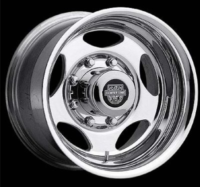

Well I just ordered these wheels 20x10 -25 offset, 4.5 bs. Not sure if the 305's will rub with the level kit.
No they will not rub with that setup. Practically what I am running
