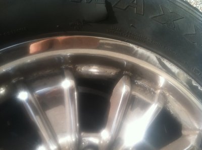

I'm going to plasti dip my badges, grill, grill inserts, chrome bumpers and rims. The chrome rims that came on the truck when I bought it are a little pitted and rusted, nothing too bad. I was just wondering if that will affect how the plasti dip adheres.

No, plastidip is actually pretty good when it comes to covering scuffs and marks. You just have to make sure that
1. Surface is as clean as it can be. Make sure to remove rust as much as possible
2. Surface is As dry as it can be (water tends to collect where it's most difficult to see - edges, crevasses, make sure it all dries good)
3. Build up layers. At least 4 suggested
Let me know how it goes! I've seen it done, but havent done it to my truck yet.
Plastidip is great when done properly

Okay thanks for the help. As long as it covers it up ill be happy. I'm not picking with wheels or how good they look under close speculation. It's a truck. I know cleaning them is wicked important but do I need to sand the chrome to rough it up or will it adhere to the chrome fine?

Oh don't sand it. That's the whole thing about plastidip is you don't need to do all the prep like for regular painting, except for a good clean.

I dont know if the plasti-dip will fix that gash in the sidewall :signs8::joke:
