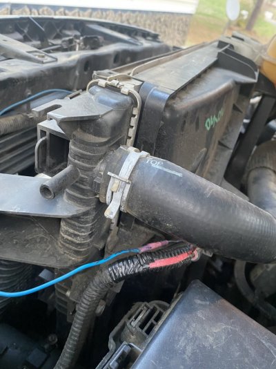

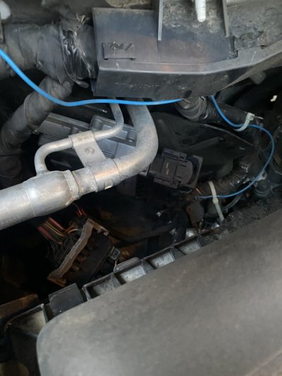

Hi All! I'm trying to help my dad find out what is going on with his '16 1500 ecodiesel. The check engine light came on while driving, and it was taken to autozone to run the code. They informed him that his radiator fan was gone, so he took it to the local mechanic. Our mechanic told him that he has no idea what's going on because the fan is wired up directly to the ecu and he doesn't deal with electrical. Also mentioned that it may have something to do with the A/C going out previously. It was bought used from a dealership and nothing was disclosed about any type of modification. I am going to include some photos of the fan, and the wiring that is running direct to the ecu. Any help would be very appreciated here. Is it stock? Is it a mod? He isn't into the modification scene and just wants his daily driver working again!

First off, the truck is out of coolant, be sure to fill that before running the engine anymore. If the coolant drops much below the seam you should add coolant. Factory coolant is the Mopar OAT Coolant that starts off purple and over time turns to an orangeish-rose color.
The stock configuration of the radiator cooling fan is an 850 watt PWM fan which is directly controlled from the ECM. The power wires go directly to the battery and should be on a 100A Z-case fuse.

That blue wire was definitely added, that's not stock. You're going to need a mechanic that can trace back and figure out what it's triggering and then back check to see why it was hacked in.
