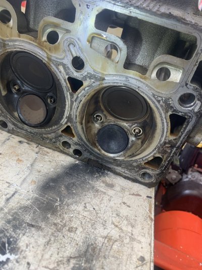

Tearing this thing apart.
This is what number 1 cylinder and valve looked like

Why number 1 so clean ?
Blown head gasket probably.Leaks coolant into that cylinder,it doesn't fire and the coolant will eventually wash the carbon deposits away.Might be worth while taking the heads to a machine shop and having them checked over for warpage,and resurfaced if they are warped.

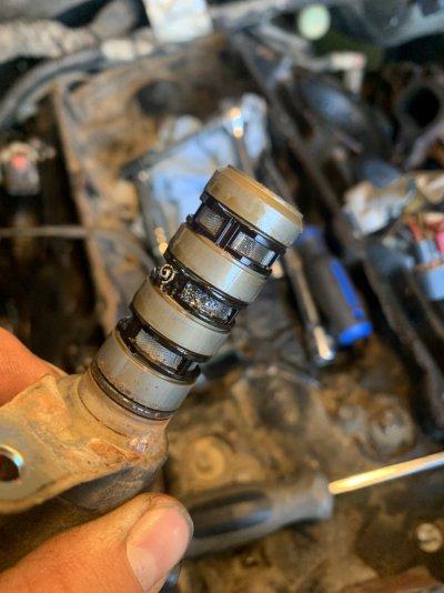

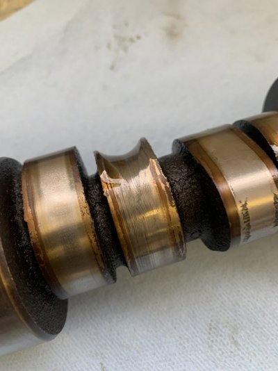

If a lifter is trashed, better check the camshaft as well. Also check for metal shavings in the oil control valve, too.

Found metal on valve
That’s what cam looked like
