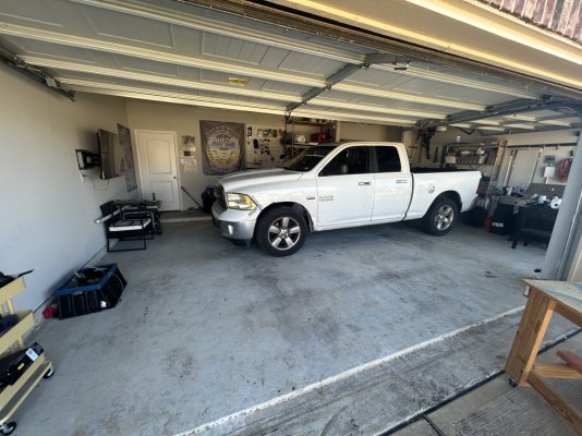

Thank you everybody. I already replaced the exhaust manifold. It did have a broken bolt but after fixing it, it didn’t fix the issue. I have moved my truck to the garage and I am setting up to replace the lifters and/or camIMG_3170.jpeg
