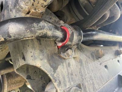

A bit expensive but best grease I have found for poly bushings. It’s ptfe/silicone based grease designed for poly bushings specifically. stuff is tacky. Will not come off your hands. Used it on my front and rear sway bar bushings. Plan on pulling my control 4x4 rear sway bar links and using this grease on those poly bushings as well.

Almost 2 months. March 9 I did the install. Still have grease on the outside of the bushing. I’d say it’s pretty sticky.
